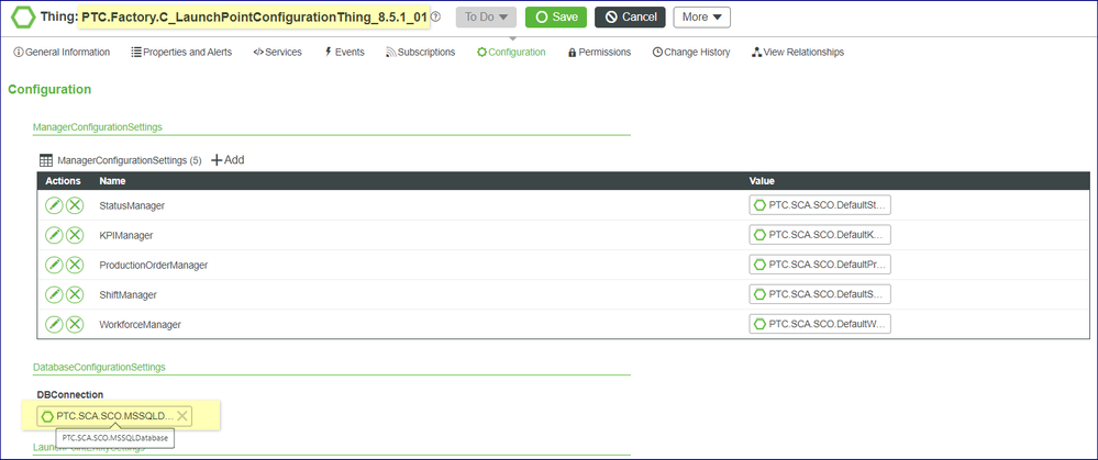

I have imported Manufacturing App in Twx8.5.1 and followed all the instructions from Thingworx Help Center.  But while performing Post Import Database Configurations, I am unable to execute "CreateTables" service from PTC.SCA.SCO.DatabaseManager thing. I am getting following error
Error executing service CreateTables. Message :: An error has occurred. Contact your administrator for further details. - See Script Error Log for more details.
Note: I have set my database using MSSQL and it is connected. I don't know what I am missing. Please help...

Hi @RajatBain ,
Have you updated the DBConnection configuration in PTC.Factory.C_LaunchPointConfigurationThing_[ReleaseVersion] thing to your PTC.SCA.SCO.MSSQLDatabase.

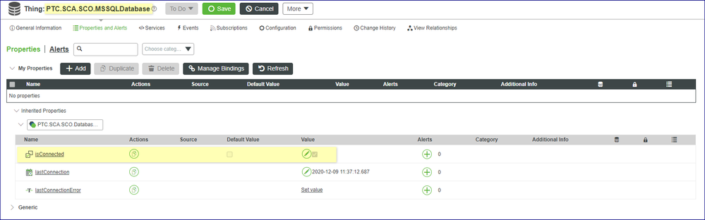

Please share the screenshot of configuration tab of PTC.SCA.SCO.MSSQLDatabase thing as well.

Hi @hchanana ,
Thank you for your reply.
Yes,I have updated the DBConnection in PTC.Factory.C_LaunchPointConfigurationThing_8.5.1_01 thing to my PTC.SCA.SCO.MSSQLDatabase.
Also my PTC.SCA.SCO.MSSQLDatabase is configured correctly and it is connected to my SQL DB.
I don't know what I am missing here. But when I am  updating the DBConnection in PTC.Factory.C_LaunchPointConfigurationThing_8.5.1_01 thing to my PTC.SCA.SCO.PostgresDatabase, my application is working properly.
So, now I know that the issue with my MSSQL BD connection, just cant figure it out.

For the sake of others in the community, while working with @MM_9639390, we found that the database thing (PTC.SCA.SCO.PostgresDatabase or PTC.SCA.SCO.MSSQLDatabase) did not reflect the correct connection information in the jdbc string.
