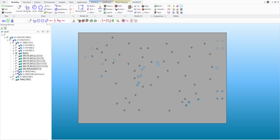

How can I create a hole table in Creo Elements/Direct? I can't figure it out 😞

Answering to my own question, how can i do a hole table?
First of all, all the holes have to be done with the machining feature, to the addon that create the table be able to identified them.
In my case i have some tolerance holes, to do that i used a addon that i have that is SolidPower that allow me to set a tolerance to a hole
Now, we move to the 2D. Im gonna use the same base for example.
To  create the hole table i use the same addon that i use to create the tolerance hole, SolidPower.
You need to:
-Choose the view
-Reference Point ( Part origin)
-Table position point
Aftter that click draw numbers to number all the holes to be identified in the table.
Final step is to draw the table.
The final result is gonna be something like that:
Hope this helps to anyone with this question.
The format of the table can be change (Row and columns width and height, everything....), but that im not very confortable.
Good work to everyone!

I want to create a 2d drawing of this base  (1st pic) with all the holes.
Normally in this type of drawing all the holes are identified with numbers or letters, and in a table (2nd pic) the location of the hole is identified with the X and Y position from a reference point.
Thanks.

Basicaly i create a CAD model, a base plate with several holes, inlcuded threaded ones. After that i need to create a tecnical drawing to be able to send the base to the production sector, to be machined.
As i said in the inicial post, i have 0 experience with this software, and i dont even know how to install the macro or even use it.
Im really surprised because this is a feature that every major CAD softwares have (SolidWorks, Inventor...), and in Creo i have to create a macro to do this.
Below is some pics oh my screen, because i dont even know if we are talking about the same software 😅.
I blur some parts in the picture only for privacy purposes.
