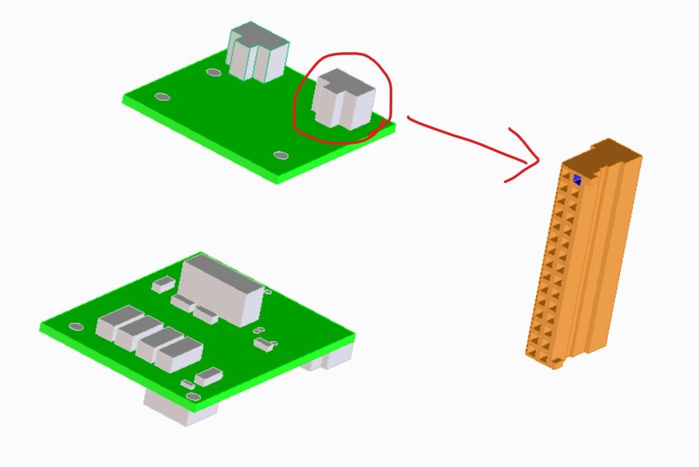

How do I show the real connectors?
Excuse me, sir
When I load the PCB, the connectors are like the cubes.
Please help check the following pictures.

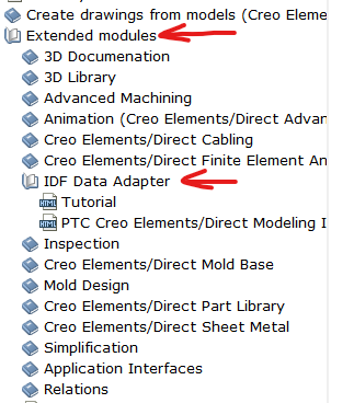

To do so, you first need to create a library with your desired geometry for each PCB part, and indicate the route for that library,.
You should have a look to the help documentation of the PCB module:
You can also sustitute each part by your desired model when traslating the PCB or individually.
