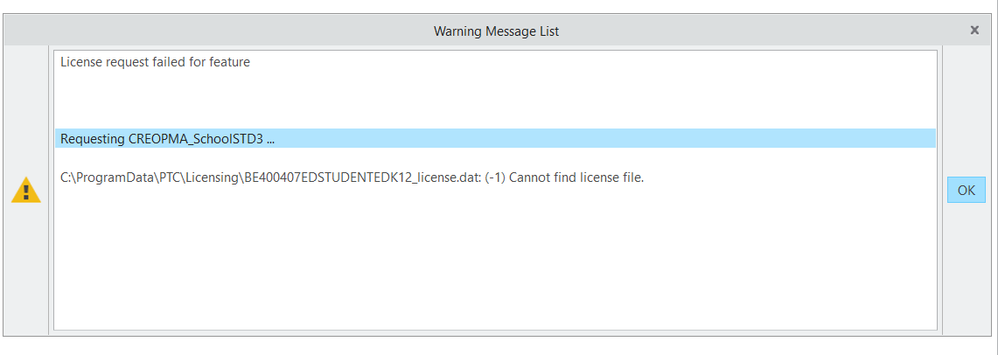

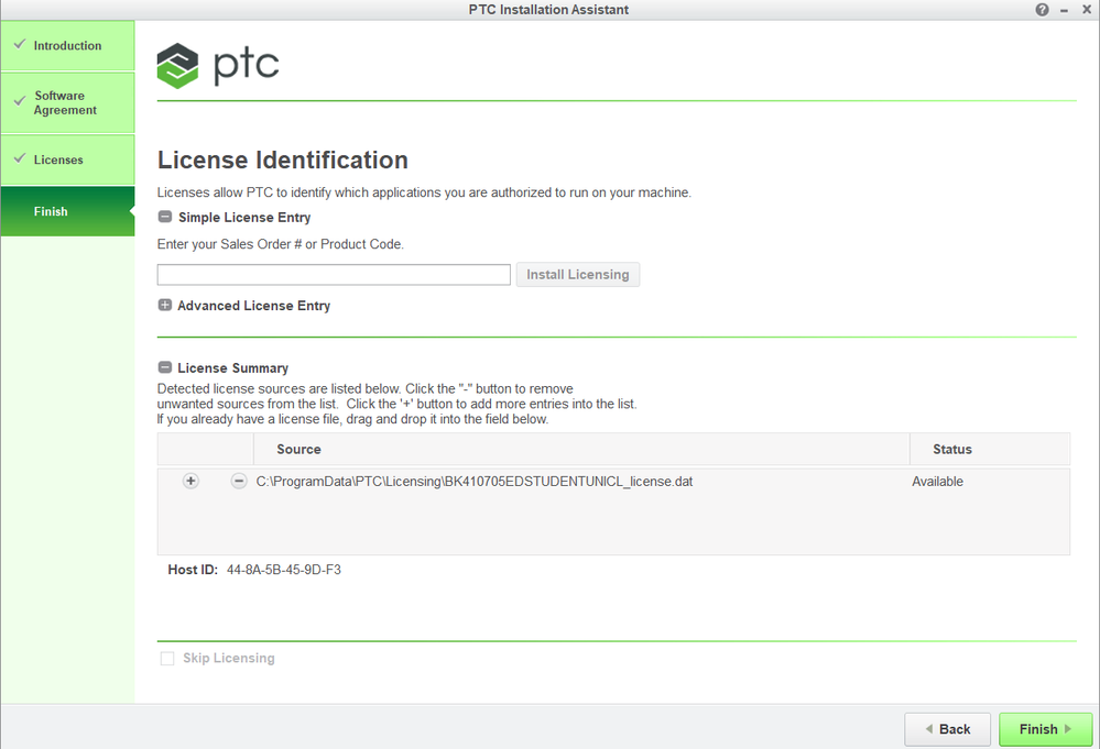

have deleted all my licenses, open the setup.exe, added the University students Product code BK41070..., close, run CREO and get this error every time.

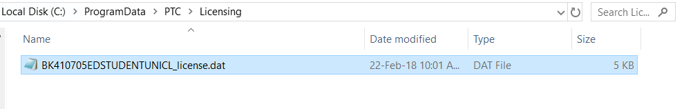

your current license file is ... C:\ProgramData\PTC\Licensing\BK410705EDSTUDENTUNICL_licence.dat
Creo is looking for ... C:\ProgramData\PTC\Licensing\BE400407EDSTUDENTEDK12_licence.dat
You have to go to Parametric\bin directory in your Creo installation and correct information written in parametric.psf file
ENV=PTC_D_LICENSE_FILE-= ... this line must contain path to license file
ENV=CREOPMA_FEATURE_NAME= ... this line must contain license name (see following example)
ENV=CREOPMA_FEATURE_NAME=CREOPMA_Student3 ()

So, could you clarify something, should I get (from where?) the license BE400407EDSTUDENTEDK12_licence.dat and add it to C:\ProgramData\PTC\Licensing plus doing all the modification on parametric.psf as you says?
Or if I edit the parametric.psf i should not add the new license file? Is so, to what license file should I point when editing?
