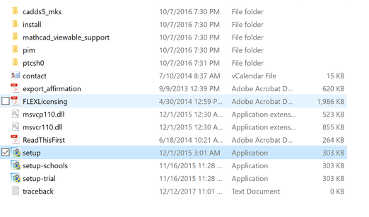

there are a lot of setup in "MED-100WIN-CD-400_M070_Win64". we should run "setup-schools.axe" . if you run "setup.axe" you will have a problem. that's all.

No, it's working in Creo 3.0 . ı had same problem but ı have just solved this problem. ı guess everyone ran setup.axe but you should have run setup-schools.axe . ı have solved by doing so

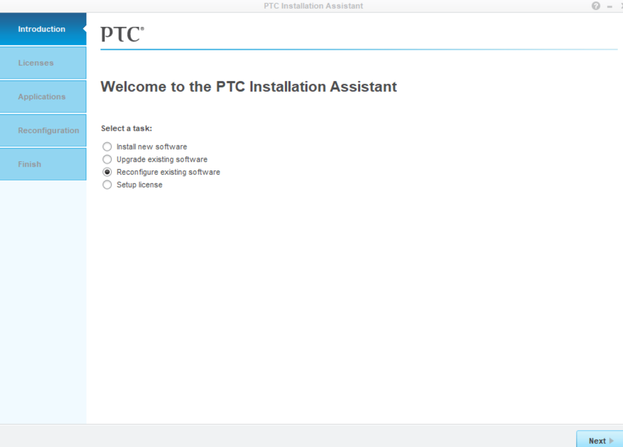

First start up "setup" application; select "reconfigure existing software"; remove all but one license source by selecting the minus button. Finish by letting installation assistant reconfig. TA_DA!
