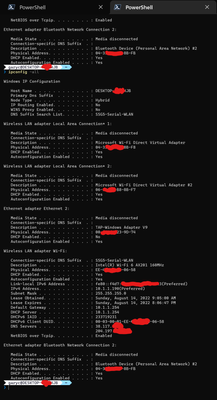

Please contact academicsupport@ptc.com. You need to send them the Host ID (Mac address of the ethernet) and also the product code used.
Alex
Not going to work because Creo installer doesn't allow me to choose MAC Address when i use license file directly. It always pick up a random one such as virtual adapter. I have to install a couple license file for ethernet, wifi, TAP tunnel...and cross my finger everytime i boot creo, hope it can detect license with cooresponded MAC. Takes roughly 5 mins trying everytime my computer goes to sleep or restart Creo now.
But, I mean, Abdul from academic support does help me a lot, he provides a great temporary fix, a light chance of having license is always better than nothing LOL. But yes, we are still waiting for a full fix with stacking installation. I cannot let every students send all their MAC Address to Abdul....it's going to be nighmare.
Meanwhile I tried Creo 6 and 7 installer with multiple product keys, same thing happened ...
I don't think we can do anything at the moment, I feel like it is caused by how windows handling MAC Address and win11 changes their virtuallization security too. Installer is not able to pick up the correct Host ID, and something wrong with server side too i guess. Abdul is trying to help me manually generate license from PTC directly. But due to the MAC Address installer picking up is a virtual network adapter, Windows change that every couple hours randomly, Need a way to manually change Host ID Setip in Advanced License Entry and ask Abdul with your real physical MAC. In the meantime, cross fingers and enjoy onshape......
