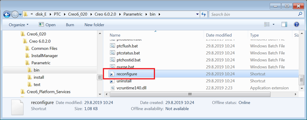

  • launch reconfigure from Creo's Parametric/bin sub-directory
  • in License Identification dialog box in License Summary section enter path to saved license file into Source field
  • finish reconfiguration

Thanks for your response. Just checked and there is no reconfigure file as far as I can tell. Does it have a specific name?

If you can't find reconfigure
then uninstall/install Creo.
During installation do not enter Product code and ... in License Identification dialog box in License Summary section enter path to saved license file into Source field.
Martin Hanák
You can also simply run setup.exe (from the folder you installed Creo) and select reconfigure existing software in the first tab. This will do the exact same thing as reconfigure.exe, but for all the software parts (Parametric, Direct, Layout...).
