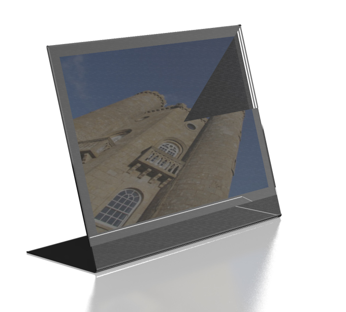

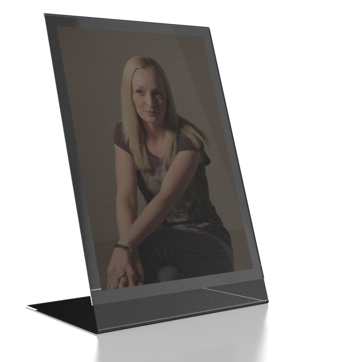

Picture holders or photo frames are really popular projects in schools which prompted me to try out the Sheet Metal (I hate that term!) tools in PTC Creo.
The secret to the tight fold is using a flange wall and choosing the 'Flushed Hem' option in the ribbon menu drop down list,
Modelled and rendered using PTC Creo.
