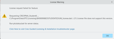

I am getting this  error while installing this software
BK900908EDSTUDENTEDUNI code enables you to install  Creo 9.0, only.
To install Creo 10.0, use BK100908EDSTUDENTEDUNI code.
Before you start installation, remove all files from C:\ProgramData\PTC\Licensing directory.
