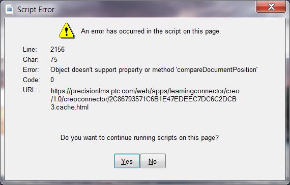

Our office is new to Creo, we were running Inventor and ACAD, but we are moving to CREO after an aquisition. We were playing with the trial Creo 2.0 and the "Learning Connector", but it would not open for us. It did not work on 2 machines in the office that were on W7(64) with EI11. The error both machines got the following error:
Script Error
Line: 2156
Char: 75
Error: Object doesn't support property or method 'CompareDocumentPosition"
Code: 0
URL:https://precisionlms.ptc.com/web/apps/learningconnector/creo/1.0/creoconnector/2C867993.....
The third machine in the office was on EI10 and it worked. After rolling back to EI10 on the other two machines, the connector openned up in its window and seems to work now. To roll back just go to programs and unistall the update to 11, 10 will then be your new browser. I was not able to find help on this so I will post this incase others are searching for that error code and "Creo Learning Connector", it may help them. Maybe we should not have been on EI11, but 11 is what was our computers were using, and the CREO list of system requirements seems to show support for EI11.

We are aware of this and are actively working on a solution to allow the use of Internet Explorer 11 with Learning Connector in Creo. It is in testing now. Once we have a firmer date for when it will be available and any steps that may need to be taken by you I will post it here.
Thanks for reporting it. I will have more information for you shortly.

This past weekend PTC University successfully applied a patch that allows Internet Explorer 11 to be used with Creo Learning Connector. This update only works with Creo 2.0 datecode M100 and later.
