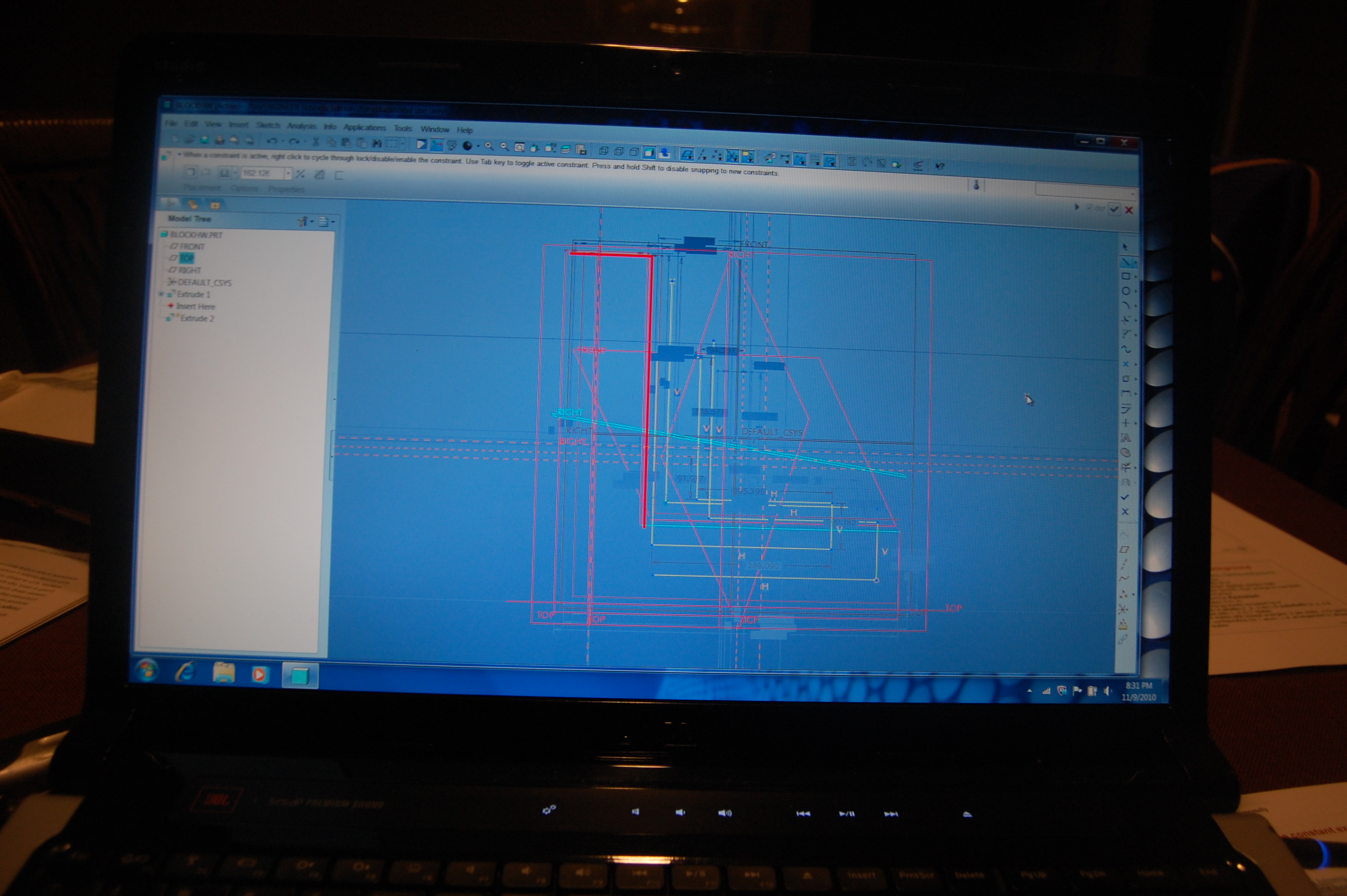

I have a weird problem running creo 5. It doesn't happen all the time, in fact I couldn't get it to happen for my teacher.When I am in sketch modeand I start to scketch, the screen shows everything i done at the same timeit is really weird.I can't figure out how to make this stop. I.ve deleted and reloaded creo 5 many times and it always happens againi can't use the program as is and I don't have the time to find a machin to complete my assignments. please help.if i move the middle button on the mouse it will go to a proper looking screenbut when I move the mouse to draw it goes back to a funky screen and I can't tell where i am drawing in the mess here is what the screen looks like149.JPG

Your graphics adapter is most likely to blame. A couple of things you can try. Change your graphics option (in config.pro) to win32_gdi rather than Open_gl and restart.
Else, try setting use_software_opengl to yes... Restart and let us know if either helps...

I got into configpro, but there is no graphics or use_opengl option in my config pro ihave a windows 7 X64OS dellhow do I find these options?
Hello Robert if you can't find the use_opengl on your config try to find it as use_software_opengl, I you have success.
that isn't on there either
some times at the begining, start setting up your config files you need to type use_opengl to initialize it in you config, then close Proengineer and open again.

try this basic config file, you will find the option that you need.
I have an intel HD graphic card and adapterin my computer.thx for the help! what do i do with this file?Ican't open it
Robert, close the ProEngineer if you have it open, then in the ProEngineer School Edition intalation directory look for the "text" folder, make a backup of your original config.pro an copy the one that attached in my last message, start ProEngineer again go to tools>options and try to find the option you need.

Ok, next step, open ProEngineer WF 5.0, and start a new part then go to Tools> Options, the Options windows will be opened, at the bottom of this windows there is a field called "Option" here is here you can look for any other option that is not use in your section, let's look for the option "use_software_opengl" set its value to "yes".
Congratulations you did it, and did it well, now try to make your first master piece Lisa you will enjoy ProEngineer WF 5.0.
