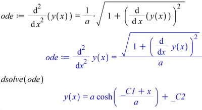

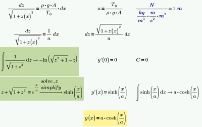

I waited, waited for an answer, and decided to solve this problem myself
Maple
Mathcad (full solution in attach - pdf and Prime 6)
May 21, 2020
Well, it's child's play, just solve the following differential equation, obtained by deriving twice the given function:
May 21, 2020
Thanks!
But I think about it
May 21, 2020
