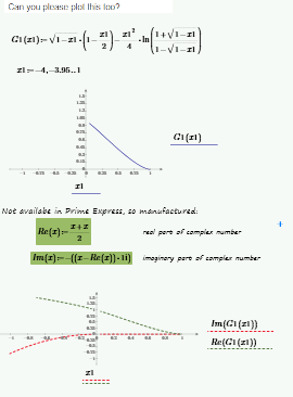

G1(x1) is like this:
Can you please plot this too?
Thanks a lot.

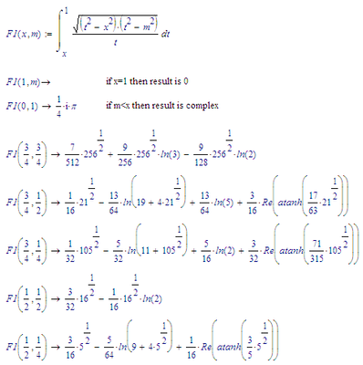

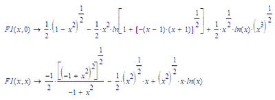

I calculated the integral, but we must study the function, for x = 1 the integral is complex. See next photo:

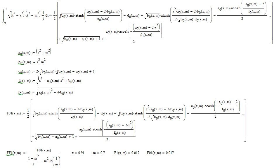

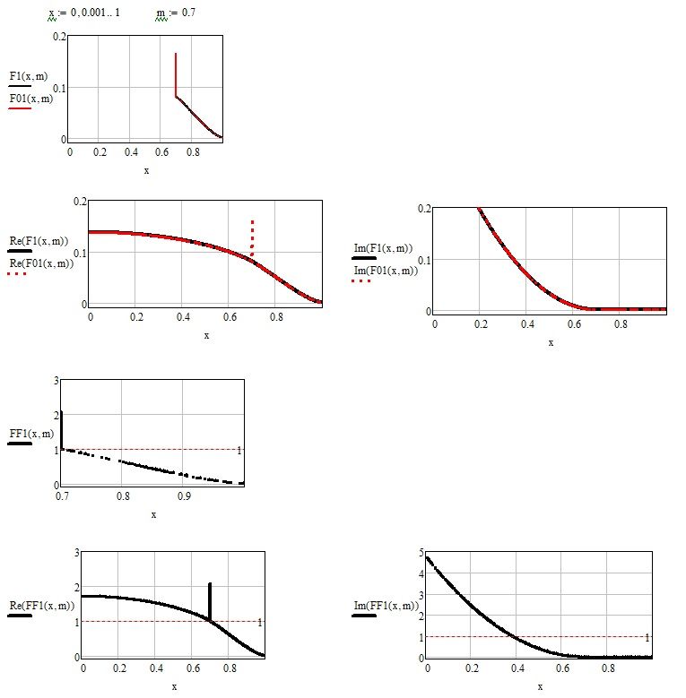

-MFra-
(To:Anousheh)
my solution, see photos:

Please let me know how you get:
1- a0(x,m), b0(x,m), etc ?
2- Red marker on the graph at "y axis=1"?
3- how do we know if we have Re and Im functions?

-MFra-
(To:Anousheh)
sorry I forgot to add the function F1 (x) to the beginning of the worksheet. Anyway, I attach the complete file. With what is provided, I think you can solve all your problems.
