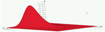

I'm a Mathcad newbie and consider myself fortunate to have been able to generate a crude surface plot of a function of two variables. This plot may be spotlighted as part of a History Channel series episode that will begin shooting in about three weeks. As such I want it to appear as "professional"-looking as possible. I have several questions:
[1] I want to "stretch" the plot in the y direction [range 0 to 4,000 feet] but have been stymied thus far. [Note: In a true-scale drawing of the plot, the y-direction side of the rectangle would be an order of magnitude longer than its x-direction counterpart. That’s obviously not achievable, but it would be nice to make the plot as narrow as possible.] PTC Mathcad Help, under Component Structure, states that “The plot area…displays the plot of the X and Y expressions defined in the Inputs area. You can use the component block handles to resize the chart area in the x, y, or both directions.” Problem is, I can’t find those handles.
[2] Is it possible to color the "mesh" in the z-direction [range 0 to 1.00]- -e.g., color it purple for values between 0 to 0.20, blue for values between 0.20 to 0.04, …., red for values between 0.80 and 1.00?
[3] Will Mathcad accommodate axis labels comprising up to 26 characters- -here specifically, “longitudinal (y) direction”, “transverse (x) direction” and still be able to include the applicable dimensional units (feet)?
[4] Can I change the worksheet orientation from portrait to landscape and minimize the margins and thus maximize the plot size?

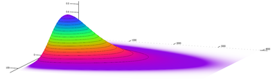

The beautiful color-banded Mathcad 15 graphic you included in your reply [see attached png file] looks fantastic- -it's virtually the exact plot I wanted to create with my Mathcad Prime software! Two questions: [1] May I use it; and [2] if your answer is "yes," would you please adjust it so that it remains "stretched" in the y direction but matches, to the extent feasible, the rotational perspective of the plot depicted in the attached Mathcad file?

You sure can use that plot but unfortunately I already have deleted the Mathcad file used for creation.
But you can also play around with MC15 plots yourself. As you have a Prime license, you are also entitled to download Mathcad 15, install it and when asked for a license point it to the license file which you got when installing Prime. MC15 will happily use it. PTC gives along Mathcad 15 when you buy Prime for good reason 😉

BTW, you can't stretch the plot in y-direction. All that can be done is stretching the 2D-pic(!) in horizontal direction and this also affects the angles between the axis. Its similar to taking a screenshot of the Prime plot and stretching it in horizontal direction:

I have recreated the mathcad 15 sheet and attach it here.
Maybe you like to play around with it, use different color maps, add lighting, fog, perspective, etc.
