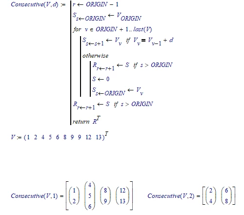

For eg. [ 1 2 3 4 7 9 10 12 15 16 19 20]. Here 1 2 3 4 and 15 16 are consecutive numbers. I want to write a general program to get only consecutive numbers for a particular matrix. Hope that helps.

I am attaching an image. m1pbias is a column vector and I want to find out only the consecutive numbers. for eg. 51 52 53 is one set. So is 59 60. There are others as well. I want to write a program to find them. Hope it helps.
I am using prime 4.0.

How about:
Note that you can set the difference that you need between 'consecutive' elements with the parameter d.
You should be able to translate this to Prime.
(To:LucMeekes)
@arnair81
What should happen if a number occurs multiple times in a row? I am aware that this will not happen in your application, but an utility function should be as complete as possible
What should be the return for the series 2-3-4-4-5 (Should it be 2-3-4, or 2-3-4-4-5, or 2-3-4-5, or ..)
Is the result as a nested vector of vector the data structure you are looking for?
LucMeekes
(To:Werner_E)
Ah, thanks Werner. Forgot to clear the new string, and to do the end-check.
Here's the corrected file:
Changed the output to a transposed array, for a clearer presentation.
Thanks to all. It is working for me now.
