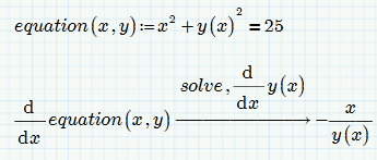

Why don't you attach a worksheet and screenshots of your attempts so we can see better what you are trying to do.
1) Mathcad unfortunately can't handle implicit functions, so you have to create one term by subtraction 25 from the LHS
2) You have to tell Mathcad that y ist a function dependend on x by writing y(x)
Hope this is what you are looking for.
WE
I didn't know Mathcad could solve this way.  To take it one step further, you can solve for dy/dx:
Werner_E25-Diamond IAnswer
Yes and we don't even need to tamper with the original equation:
OR
OR better
Werner
P.S.: If you encounter problems or get 0 as result, check the labels of your variable and function names. Prime automatic labeling really is erroneous and annoying.
