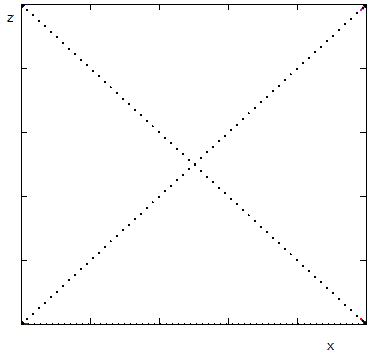

When I have 20 elements in vectors with operators (for parallel calculation of 4 curves) all is OK!
When I have 40 elements in vectors with operators (for parallel calculation of 8 curves) it is not OK!
See please attach!
My Mathcad Prime 4 is break when I open the converted 8-Flyers file!
Help please
One mathematics teacher (a women!) from the Air Force Academy found a mistake in my model!
See please the attach!

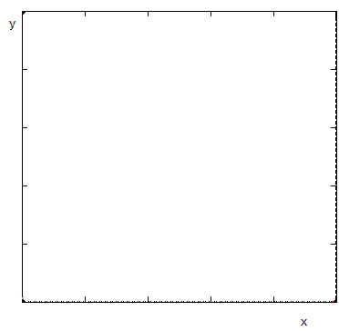

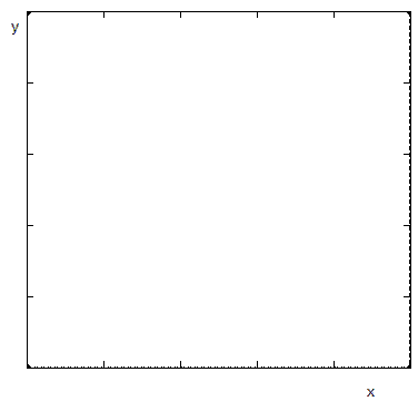

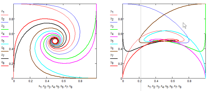

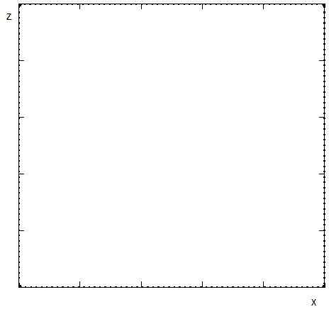

Here is what I see in MC15
and here is P5
Thanks Alan and Werner!

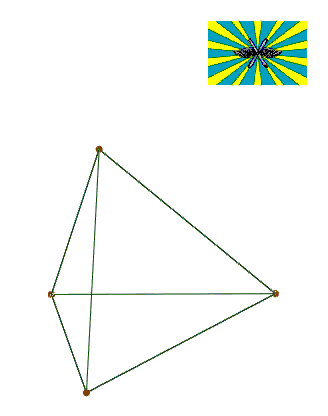

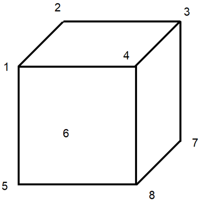

8 bats fly out of cube tops. They fly in pairs against each other 1->2, 2->6, 6->7, 7->3, 3->4, 4->8, 8->5 and 5-1 (see the picture). The model with 4 bats works without errors. In the Model with 8 bats - the wrong answer. This is my mistake or mistake Mathcad. May be Mathcad can work with 20 operators in the vector and cannon works with 40 ones!
Still not clear to me what you think that is going wrong.
May be the picture tells about the error!
Yes, I see the problem now. Haven't checked if its your setup or if its Mathcad doing something wrong. Your converted sheet shows the very same result in Prime 5.

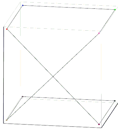

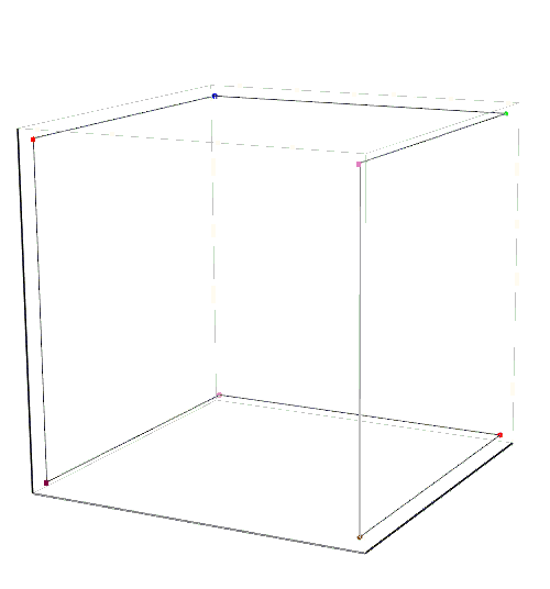

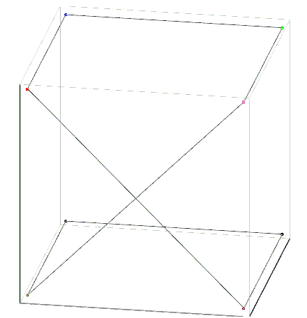

See animations! Is it correct - not square and the meeting not in the center of the cube?
The final position being off-centre results from your initial target positions.  You have two points that start chasing targets on vertices along diagonals (in the x-z plane), while all the other points start chasing targets at adjacent vertices along edges.  If you start with a a more symmetrical arrangement (such as all points chasing targets on adjacent edges) you end up with a central final arrangement.

Simply exchange the start coordinates of points 5 and 8 and also of points 6 and 7 to achieve a better symmetry.
A real perfect symmetry would not be possible using all 8 vertices of the cube.

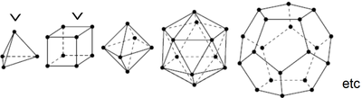

You may consider using the 6 centre points of the side surface squares of the cube (vertices of a regular octahedron).

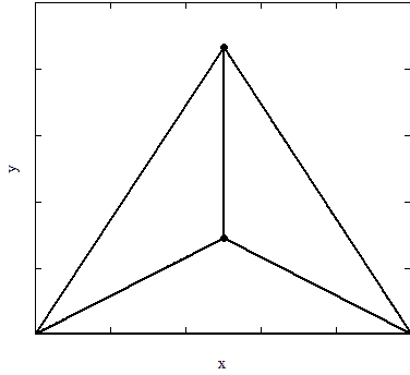

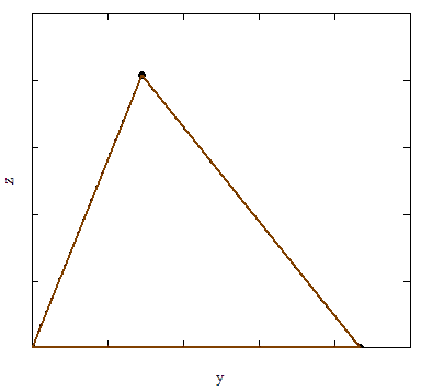

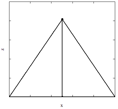

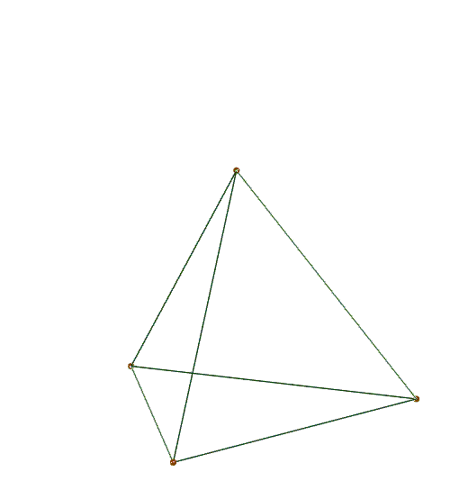

Not an animation but 3 views of 3D picture:
But the question is still left!
Is it my own or Mathcad 15 error?
I guess its not Mathcad but the way you had setup the problem.
There sure should no points go outside the tetrahedron.

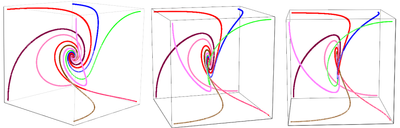

I digged into my archive and found an old sheet were I played around with a similar "problem" and quickly adapted it to your scenarios. Here's what I see:
