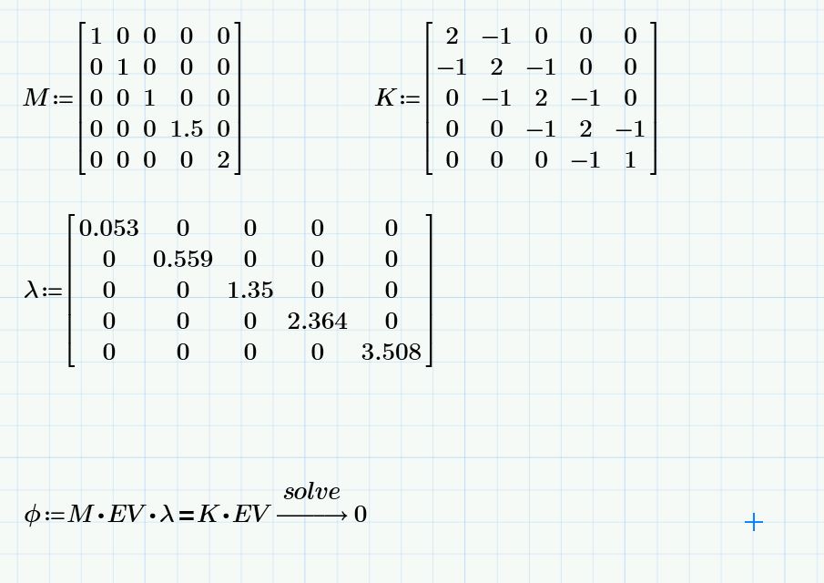

Hi, everyone,
Right now I just want to find the non-trivial solution to the last equation above,
I can find that using the solve block, but since solve block cannot be used in programming,
I am afraid I have to find another way to solve a Matrix function with non trivial solution.
In Matlab, [eigenval, eigenvecs] = eig (K, M) would return to EV as eigenvecs, using the equation M*EV*lambda = K*EV, and it is easier for programming, say K & M varies.
So is there a way to solve non-trivial solution to a Matrix Function other than the solve block in Mathcad?
Thank you for your help!
Best
Shawn

(To:sfan)
Have you tried "solve, fully" ?
But as long as you don't tell Mathcad that EV should be a vector or matrix, you will just get 0 as solution as this is the only solution of this equation - Mathcad treats EV as a scalar.

You can't put a solve block in a program, but you can turn a solve block into a function:
phi(K,M):=Find(EV)
Then you can call phi(K,M) in a program with different K and M,

This is what I meant:
There are two solve blocks, in cyan and yellow, that have been created as function definitions. The layout in Prime is a little different, but it works the same way. Once the functions have been defined they can be called anywhere later in the worksheet, including in programs. Note the use of symbolic evaluation of the first function to find all the eigenvalues, not just the one nearest to a guess value.
I don't suggest this is the optimal way to find eigenvalues and eigenvectors, but it shows what I meant.

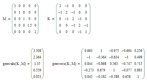

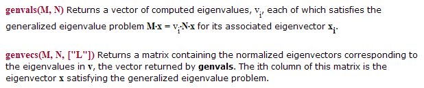

(To:sfan)
In Matlab, [eigenval, eigenvecs] = eig (K, M) can return to both lambda and corresponding EVs, but not sure how to achieve it in Mathcad.
Would this help:
sfan
(To:Werner_E)
You are my hero!
