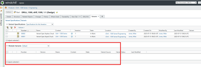

I am on exercise 7 now and run into a discrepancy between training material and Windchill.
When creating a variant, I go to Actions->Configure.
The Configure window that I see on the video recording has 5 stages with the last one being "Module Variant".
When I try to do the same in Windchill I only get 4 stages, with the last being Variant Specification.
So I create Variant specs, but no actual Module Variants it seems:
 Have I missed a step or something?
Jucara
6-Contributor
(To:PD_9138185)
Please, may you try to check-In the Configurable BOM?
No that you mention it, it does say at the end of Exercise 6 to check in and checkout objects. However, I ignored it as I have not check out anything.
I cannot test it now as my session expired, but I will try to re-do everything tomorrow and let you know.
Regards
Pawel
Checking in the BOM made the trick. I was now able to create both Variant Specifications and Module Variants.
Thank you!
