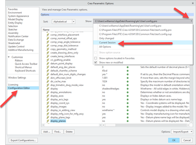

Double check your config settings by going to FILE - OPTIONS - CONFIGURATION EDITOR.
Select the drop down arrow on the list and select "current session"
Find the option and make sure it is set as you want. If it is not, then you may have more than one setting in your config files.
You can also review all your config files using the same drop down arrow!
