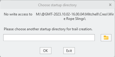

The drawing won't open and says "(title of drawing) cannot be retrieved". Has anyone else had a problem with a drawing not being able to be retrieved?
No matter what I try I cannot get the drawing to open. This drawing has many sheets with a lot of information and will take many, many hours to recreate.

Ya, that folder name is not going to work with symbols and periods I doubt.
Its trying to save a trail file, so did you open via a double click? That made that odd folder the startup folder.
Open creo normally using the icon, then navigate to the folder to open the file so creo opens correctly.
Keep the latest version that works in the original folder, move the newer versions out so you can do your research to see what is missing and what would need to be redone. This may only be good for understanding the implications of going back versions and may not be your solution.

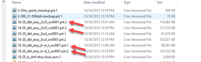

Since you are on the hard drive, unless you have specifically turned of the file version, you will have copies of the drawing for each save.
DON'T DELETE VERSIONS, Temporarily move to a non-searched folder for testing.
You can go back to older versions and see if they work. Maybe it's only something recent and the amount of work to redo is minimal.
You may have to show file extensions in your file manager to see the versioned files correctly.
Example of file versioning:

I went back to previous versions and I am able to open them up but I am now getting a message saying there is no write access to the folder I am selecting.
StephenW
(To:MS_9913832)
