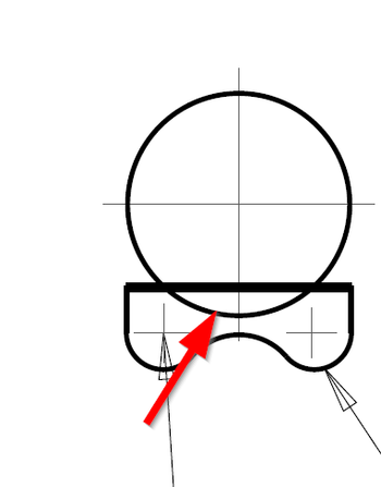

Hi guys,
I can't figure out how to adjust the settings for the following case. There's line (that lower part of the hole) that should be invisible because it is behind the object (bracket).
Any ideas? Everything else is great.  Thank you 🙂

In the view properties, do you have the view display set to NO HIDDEN?
If there is intereference in parts assembled, that can also sometimes cause odd display issues.

Yes. It is set to NO HIDDEN. And there are no interferances. Are there any other settings that might affect this?

The other possibility is that it's a surface which is controlled with a separate setting, particularly in section views.

If there are surfaces and the view is a cross section, you will need to do the following:
1. in the model cross section definition, under the MODELS tab, you will need to check the INCLUDE QUILTS box
2. in the drawing, under view properties, view display, make sure the option HIDDEN LINE REMOVAL FOR QUILTS is set to YES.

Can you share the drawing and models with us? It would be much easier to figure out.

Isthere any sketch or curve that is not hidden?
