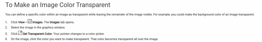

Assuming you are using the images functionality to place the image in your drawing. Follow these steps.

Here are the steps:
1. Click Layout > Images.
2. Click Import.
3. Locate the image file, select it, and click Open.
4. Drag the image to where you want it placed on the drawing.
5. If desired, adjust the image's scale, rotation, and/or transparency.
That's it! The imported image file becomes part of the drawing. And note, the system doesn’t require object linking and embedding (OLE).

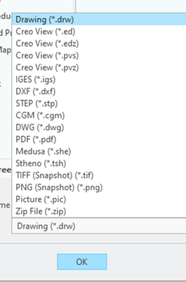

I understand what you both are saying. I can upload a transparent image into CREO drawing file. However, when I try to save the file, I can only get the file types shown in the picture above (none of which are the format file type). Any ideas on how to proceed? Thanks for the help tbraxton and BenLoosli!

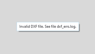

Unfortunately, it does need to be a transparent logo. I have downloaded Inkscape and converted the PNG into DXF. I have not been able to successfully upload the dxf into CREO. What pathway would you use to get a DXF on a format?

Is it throwing an error? DXF is a supported file type. File-> Open -> change type to DXF -> Select it and click open.
When I try to open it in a format I get the error message shown below
Do you happen to have a seat of AutoCAD? Sometimes AutoCAD can fix DXF errors that Creo cannot.
