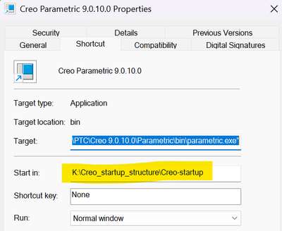

I don't know why you are using scripts etc. to make a centralized config possible.
The easiest way, my company uses it for more than 2 decades, is to set the [Start-in] directory.
You can do this by right clicking the CREO Start-UP button (Most probably shortcut on the Desktop) and select [Properties].
The K drive (server) is the location where the config file is.
