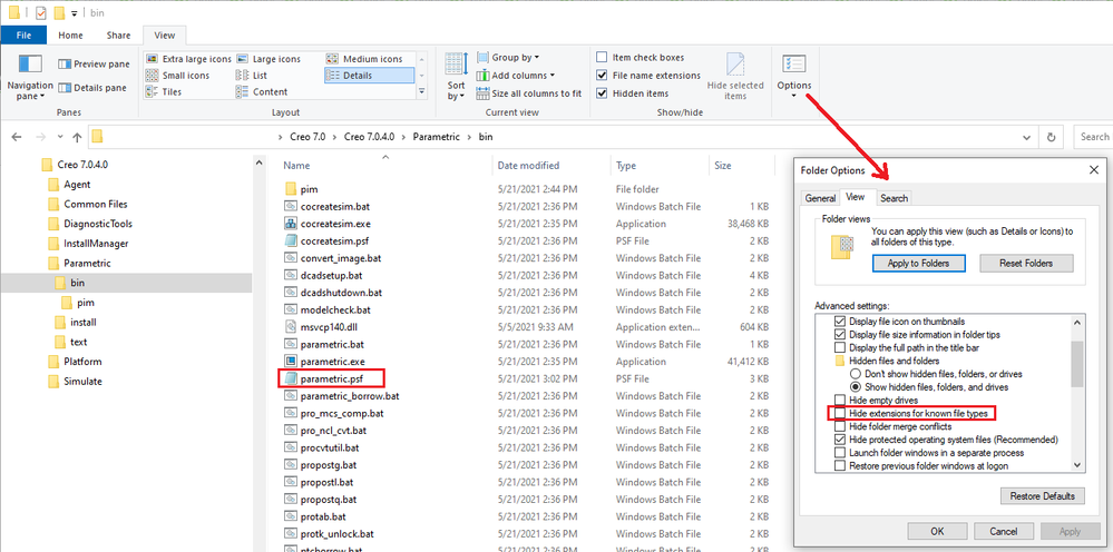

 Thanks for this information.  Quick question:  So under my /PTC folder where might I locate this .psf  object so I can make the change?
BenLoosli
(To:RB_7471070)
\PTC\Creo4m080\Creo 4.0\M080\Parametric\bin
Replace your version information with what I have.
TomU
(To:RB_7471070)
It's just a plain text file.  You can view it in any text editor.  Notepad, Notepad++, etc.

So I found the .psf object and made the change for the new license file but now it is a txt file and not a psf. Also when I start CREO it is still complaining about the old license. I am confused.

Hmmm, seems like you opened the .psf file, but maybe when you went to save it the default .txt extension was used. Perhaps there are permissions problems on writing to the directory?
If it was me, I would save a copy of the original .psf to something with the extension .psf-old, but it might be too late for that.
Some windows installations are weird about writing file into the C:\Programs directories. They won't let you overwrite things, but you can rename  or delete the existing file and then write the new file. Hard to determine without seeing any error messages.
LOL - yes I saved the original .psf file under a different name so I still have it. And yes I had to change permissions so I could edit the object and save it. By using notepad to make the change it is now a .txt and not .psf.
Then just rename it to a .psf. Click on it and right-mouse-button, look for Rename.

The icon that Windows chooses to assign to the .psf file doesn't matter, but the file extension does.  Do you have file extensions displayed?  If yes, make sure the extension is still .psf and not .txt.
