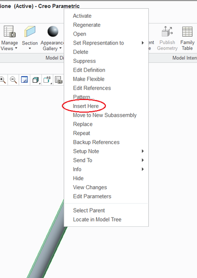

I am trying to record a mapkey in Creo for the Insert Here command, in an assembly:
I want it to be universal, obviously. I recorded it with the mouse, and it works in the assembly of the record, but doesn't in others.
Does anyone know the command line I might insert in the config.pro to make it usable everywhere and always?
The current lines of the recorded one are the following:
thanks
Tommaso

 See attached below a snippet from our mnemonic set of mapkeys for Creo 4
 to use
  1) Select part/feature you wish to insert below [it should work in part
and Assembly mode]
  2)* hit mapkey ih this should enter Insert Here mode
     (* If it doesn't work first time hit ih again, the toogle function was
probably left in exit mode)
  3) To exit either
     a) hit ih again - should toggle and automatically resume suppressed
     features/parts
     OR
     b) reverse hotkey, e.g hi, and this should start the exit insert mode,
but leave the user to hit the yes prompt

Hello Cadcam,
thanks very much for your reply and I am sorry I couldn't reply before.
I have tried your mapkeys but they don't work (I am using Creo 3 if it may matter).
In the lower left corner the message "Playing mapkey ih.." appears, and nothing happens. I have also tried to hit once more but with no success.
Anyway I found the solution, It was just to simply insert the line:
mapkey(continued) ~ Command `ProCmdActivateInsert`;
to enter insert mode
and eventually another mapkey with:
mapkey(continued) ~ Command `ProCmdResumeLast`;
to resume last set.
(no need to have a toggle function for the moment, even if it would probably be a finer solution).

Thanks for the hint re resume last.
I have included it in the ih (toggle) and hi reverse command below. Seems to work in Creo 4.0 M020 and Creo 3.0M100
Regards
