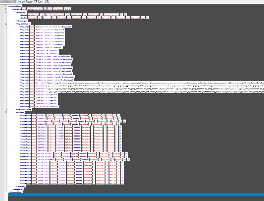

When I open CP4 in Note++ I only have 65 lines (all unfolded)...and the config options are all next to each other..??
Hi FST,
you're right, there are many options next to each other.
But this is how the User Defined Language files in Notepad++ work.
So, don't worry about that.

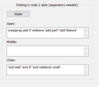

Does anybody have a Notepad++ UDL for Pro/Program??
Regards, Steve
@seckart I know that this is a few years late - but I don't have the full udl set up, but did get the basic setup for some of the pro/program keywords which you can just type in to the 'Folding in code 2 style' box in the UDL setup
Hope this helps
