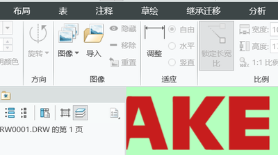

Thank you for answering my question. My main problem is how to insert a PNG image with a transparent background in the format file. I saw that it is possible to insert a PNG image with a transparent background in the drawing file, but in the format file, it seems that the image can only be inserted through OLE by inserting objects. I imported it through the built-in drawing software on my computer, and the background has become opaque and pure white.
The above two images are the appearance of imported images in a format file. The transparent background of the image has changed to a white background
The above image was imported from a drawing file with a transparent background

ask PTC support to let you know if it is possible to instert png in a format with a transparent background.
I guess such functionality is not implemented and you will have to use drawing template instead of format.

Fact A black or white background will display when image with transparent background is inserted as an Object in a format file is a working as designed behavior, refer to article :
https://www.ptc.com/en/support/article/CS364138
