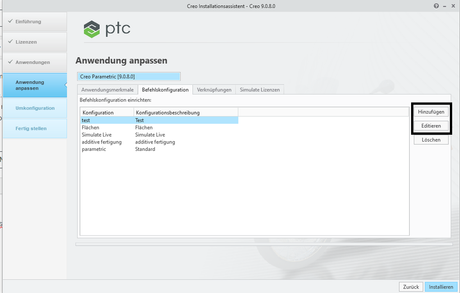

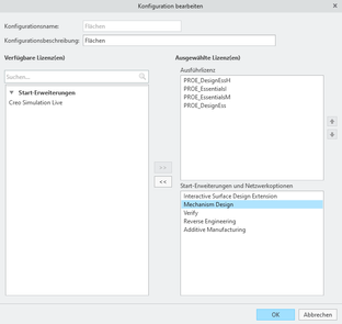

Thats how we were doing it. At the install you can create different start Profiles with different licenses. This is the german view, but should be looking the same in your language.
Just edit or add an command configuration and select/deselect your license packages
