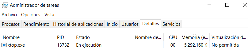

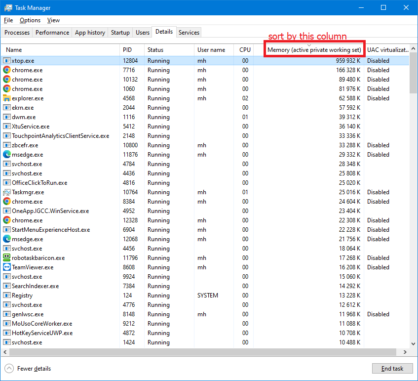

open assembly and track how much memory takes xtop.exe process (in Task Manager window on Details tab).

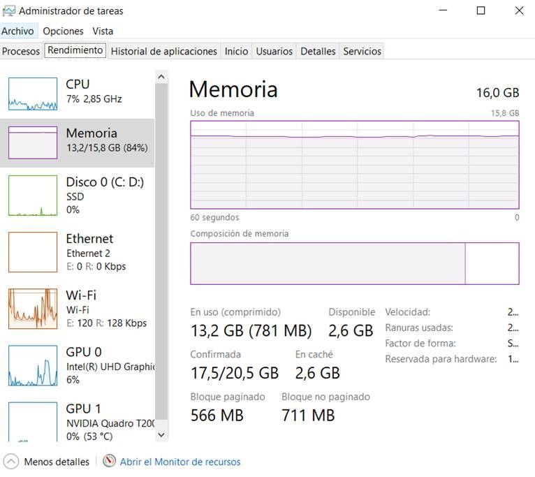

Having only one open box model, it is with almost 90% of the RAM consumed and the PC freezes continuously for sometimes seconds, sometimes even several minutes, making it very difficult to work.
Currently I have 16 GB of RAM
exit Creo session, start new Creo session, open assembly and publish following "pictures".

Sorry for the delay in replying, I attach the screenshots.

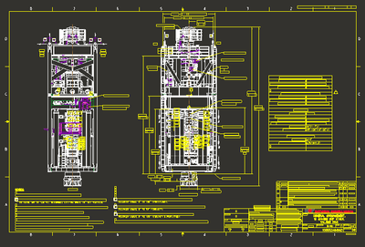

The problem is that this happens to me when I open AD (assembly drawings), which are assembly drawings of the whole box, then I can not simplify, and every time I open the model is 20 minutes and since you move the mouse until it moves 15 seconds pass ....
