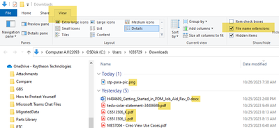

In Windows, File Explorer go to View tab, Options, and check File name extensions. It is still a STP file , but Creo is listed as the software used to open it.

Looks like the option for "Open with ..." a different software than the default was selected and the check mark for "Always use this app" was selected. Th e file is still a STEP file as llie shows.
