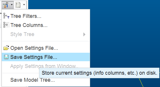

it looks like you want to see features in Model tree in Assembly mode.
  1. use Tree Filters command
  2. use Tree Columns command
  3. use Save Settings File command
  4. in config.pro define mdl_tree_cfg_file option (value = path to file save in step 3.)
Martin Hanák
BenLoosli
(To:bcat)
pro_group_dir X:\PTC_Settings\Features
