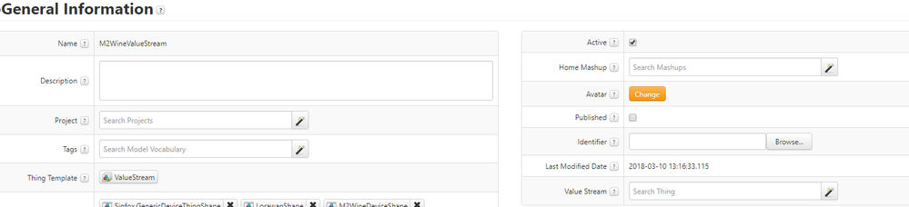

Hello
Thanks for advices
I found the issue by corellation of the issue date & modifications don :
I put a value stream itself for the value stream field which probably created the issue.
The problem is that I have this error in the application log for a value stream
Thing [M2WineValueStream] has logged properties but does not have a valid value stream assigned
Do we have to fill the field "value stream "for a value stream ?
what to put there ?

I've never tried to add a property to a Thing of type ValueStream... Usually you will make a Thing and add a ValueStream to that thing (or thing template). I actually don't know what happens when you add a logged property to a Thing of type "ValueStream"... That's definitely interesting. If I get a chance to try that out I might.
