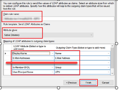

Hi Community,
We have trying to enable SSO on Thingworx using ADFS as IDP. We followed steps suggested in this link - Configuring Authentication with AD FS (ptc.com)
When we enable SSO on Thingworx, we are getting below error
2024-06-29 04:54:29.694+0000 [L: INFO] [O: o.s.s.s.l.SAMLDefaultLogger] [I: ] [U: ???] [S: ] [P: ] [T: https-openssl-nio-443-exec-8] AuthNResponse;FAILURE;<<IP>>;<<RELYING_PARTY>>;https://<<ADFS HOST >>/adfs/services/trust;;;org.opensaml.common.SAMLException: Response has invalid status code urn:oasis:names:tc:SAML:2.0:status:Responder, status message is null__	at org.springframework.security.saml.websso.WebSSOProfileConsumerImpl.processAuthenticationResponse
Could someone help me to solve this issue
/VR
 Fixed issue with help of Support Ticket.
Disable Signing Certificate Trust Check in ADFS - java - Spring SAML Single Sign on ADFS Response failure because status message is null - Stack Overflow
Removed SAM-Account-Name from Claim
/VR
/VR
