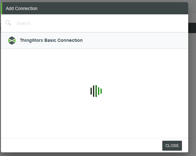

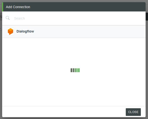

Hello all,
When I try to add New Connection in Thingworx Flow, it got stuck in addition screen. PFB PNG for reference
@weli Could you please help me with this issue ?

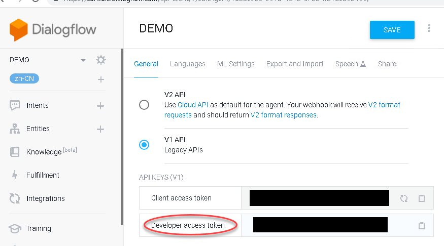

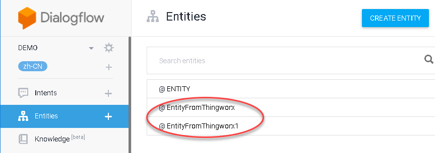

I  don't know much about Dialogflow, but I just tried and can successfully create entities  for Dialogflow from Thingworx flow.
Please make sure you can access Dialogflow first. Then using the following config in Dialogflow:
Use v1API and developer access token

Hello @weli ,
Not only DialogFlow, I'm not able to add any connection in Thingworx Flow.
