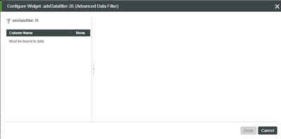

I have a mashup (migrated from 8.5 to 9.2 TWX) that contains the Advanced Data Filter Widget.
I'm unable to configure the filter fields in 9.2. The configuration popup shows up blank even though data is binded to it.
Hi @slangley ,
I used the ‘Chip based data filter widget’,which comes as part of thingworx standard widgets. This has the same functionality as the earlier one, and is fully compatible with thingworx 9.

Is that a custom widget?  The latest releases have a legacy data filter widget you could try.

Hi @slangley ,
