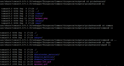

Is there any way to update the Advanced Grid in 9.0 with some custom code? It appears that the Advanced Grid widget code has been minified and obfuscated in the advanced-widgets-bundle.js file. I'd like to be able to modify that so I can get all of the table rows in the editedTable property of the widget. I could try and grab an older version of the advanced grid and modify it but I notice there were some improvements made to it in 9.0 that I don't want to remove. Thanks!
All Widgets are stores in Widget directory in the Thingworx folder.
You can grab it change it and the version in the metafile and upload it as your version with different or the same name (replace).

Thanks for the quick reply! However, in 9.0, there is no longer runtime.js files at that location (see attached screenshot).. I'm not sure if it's because they've migrated to mostly web components.
@bot1q ,

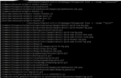

Additionally, when I do a search for advanced or grid in the whole web app folder, the only .js files are bundle files:

Not really looking for an improvement. Just wondering if I can either:
a. download the 9.0.1 Advanced Grid version from PTC somewhere or
b. get some advice on how to extract the Advanced Grid widget from my ThingWorx server somehow

Thanks for the suggestion! Unfortunately, Advanced Grid is not an extension any more in 9.0. It appears to come with the platform OOTB, so I'm not sure that Solution Central would need to package that up with the rest of the entities.
