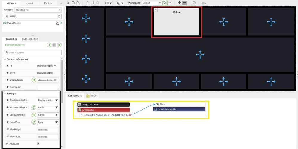

I'm beginner to thingworx and I'm having very difficult to configure a value display widget.
I was able to bind a data on value display and it is having worked well.
My problem is:
How to configure the color, text, font, alignment that value display?
Below is the picture of my mashup with value display and its configurations:

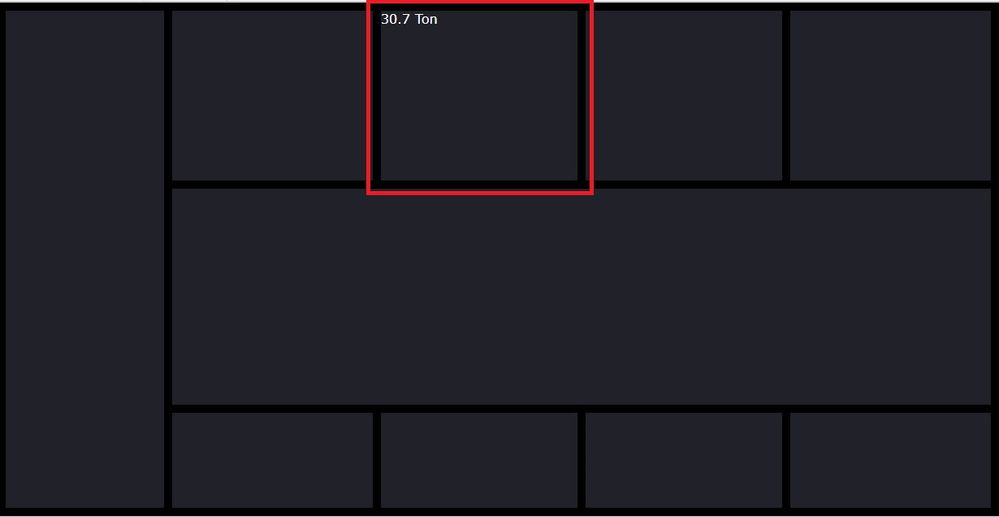

And below is the picture of my mashup in mode run:
It's possible to realize the wrong alignmente and I already tried to create a "Style Theme" and it don't work.
Can anyone help me with this alignment issue?

There is an issue already reported with value display, please see here: https://www.ptc.com/en/support/article?n=CS319193
For center alignment, you can use following custom CSS:
.widget-ptcsvaluedisplay
text-align: center !important;
Hope it helps,
Raluca Edu
22-Sapphire I
Jan 14, 2020 1:52 PM UTC
There are style themes that are basically CSS layers/definitions
but for just the value display for starters it might be easiest to just set the Style Definition in the properties to one that you want.
Something I think that might be called ValueDisplayStyle and it has a painter's palette as the icon.

@einsfeldleo  Additionally, there is another issue reported at https://www.ptc.com/en/support/article?n=CS316985.
The article shows a workaround using Style Scheme to address the color, though the Custom CSS solution presented by Raluca should also work in theory for color too.
