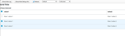

I am using ptcs-grid with multi-row selection enabled.
The first row in my grid is a “Total” (summary) row, added through a service.
I do not want this row to be selectable, and it should also be excluded when “Select All” is used.
Since CSS solutions only hide the checkbox visually (and do not affect selection logic), I would like to know:
What are the supported alternatives or best practices to handle this scenario?
how the Data is looking on grid i am here attaching the screenshot.
from this screenshot i want to Hide the Checkbox for the 1st row whose department="Total"
Best answer by DanWolf
Depending on your ThingWorx version, you can use the Grid property "AllowDisabledNodes".  Check the box then choose a value for "DisabledStateField".  This field is a string.  Any rows with that string value set to "disabled" will disable the row.  I created a quick test and here's a screenshot showing the result when I use Select All.  I cannot select the row and Select All does not select the row.
