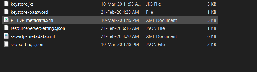

I'm trying to integrate Azure AD for SSO, I have configured Thingworx platform-settings.json and sso-settings.json as in documentation. When I start Thingworx I get following error,

You are using also PingFederate?
The error is related to keystore, could you check if you have such file?

Hi @raluca_edu ,
Yes I have created and placed keystore file in mentioned location.

Could you attach sso-settings.json (remove any credentials before) and pingfederate/logs?

Hi @raluca_edu
Thanks for the response.
PFA the log files & json file.
Is there any specific method to create and verify keystore file. I created keystore using cmd from online.

Hi @raluca_edu
I have solved key issue it is due to tampered keystore file.
Now I'm facing new error,

Follow this article: https://www.ptc.com/en/support/article/CS275630
Please add a full path for idpMetadataFilePath in sso-config.json
