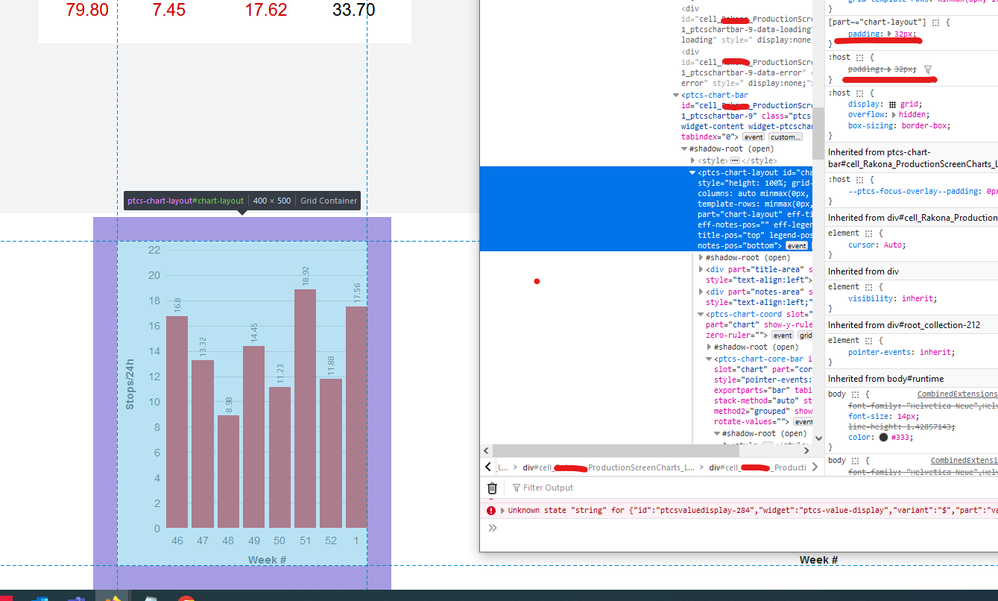

I am implementing mashup for a client and he wants to display on screen various bar charts, similar to those  you see in the picture. I used Themable  Bar Chart in Thingworx 9.3
I used collection widget, each collection cell has only has this single chart widget.
The problem is that client screen has small resolution and I can not allow to widget to have 32px padding. (see picture)
Is there a way to remove/modify this two CSS rule (:host{} and [part~="chart-layout"])  from Shadow DOM?

Hi @IR_10730188
You can use Custom CSS to control chart padding
.customCss ptcs-chart-bar::part(chart-layout)
  padding : 10px;
Or directly on Widget Style Properties
/VR
