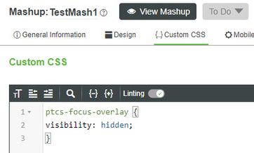

Got your issue,  you can add the following to the "custom CSS" tab of the mashup.
ptcs-focus-overlay {
visibility: hidden;
Then the border wouldn't appear when you click the value.
/Yoyo

Hi Yoyo, I'm not using the TW Menu item, I'm using the value display widget. I already tried to modify the style without success.
visibility: hidden;
/Yoyo

Yes it is working fine, thanks a lot!
