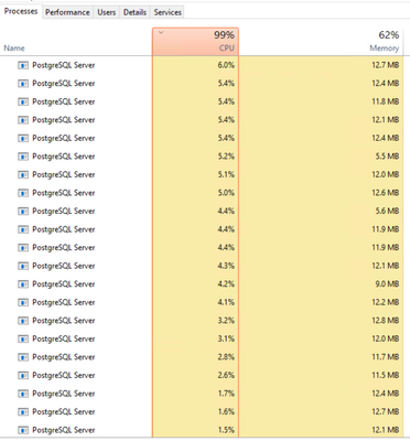

In customer's system,  the CPU usage is 100% because of the processes of PostgreSQL.
  1. If restart the postgresql service , then the cpu usage will creep to 100% in about 10~15 minutes

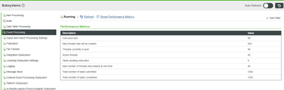

  2. The event processing subsystem received 1.5 tasks per seconds .  The active threads will increase until 75 (see the attached picture )

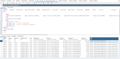

  4. No dead lock found by running the sql "select pid,
    usename,
    pg_blocking_pids(pid) as blocked_by,
    query as blocked_query
    from pg_stat_activity
    where cardinality(pg_blocking_pids(pid)) > 0;"
  5. Query the table pg_stat_activity, found lots of long xact_stay,  but no long query_stay. (see the attached picture )
  6. CPU usage. (see the attached picture )
Any idea about it ?  The  workload is not so heavy , why is the CPU usage so high?

All the transaction shown (aside from autovacuum), seem to be operating against the data_table.  There is a know performance issue with this table:
https://www.ptc.com/en/support/article?n=CS261063
I would recommend:
1. Adding the missing index above
2. Running vacuum analyze data_table;
3. Running select entity_id,count(*) from data_table group by entity_id;
If you provide the output for #3, there may be some platform data that could be truncated to speed up these data_table queries.
