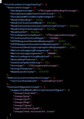

I’m facing a database connectivity / connection pool checkout timeout issue during ThingWorx Foundation startup against AWS RDS PostgreSQL 16.6. ThingWorx goes into ERROR state even though database connectivity works from other clients.

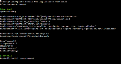

  5. Rajkumar_20673_0-1766819934161.pngRajkumar_20673_1-1766819973376.pngRajkumar_20673_2-1766820084831.png
