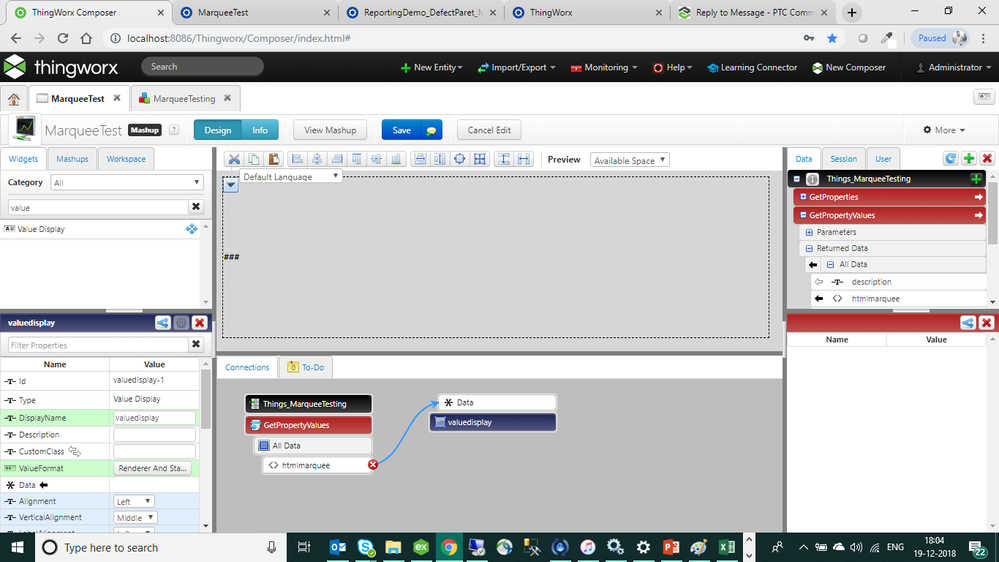

I created a new Thing with a property with HTML Base Type.
The Marquee tag is not working there, but bold and italic etc. works nice.
This is probably forbidden due to XSS security reasons - good for the website, but makes it more complex for the designer.
In a Mashup I added a ValueDisplay Widget and bound the HTML property to it.
Then set the Renderer & State to "HTML" - "With Formatting"
Your .css is working - BUT it's not applied as the Value Display will have several inner containers and divs, so the custom css class will probably not affect anything.
In the F12 Tools, I've found I can use the css class from the Value Display.
Set the "Custom Class" to empty (reset if needed) and use the following Custom CSS for your keyframe animation:

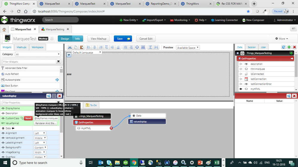

Hi mneumann,

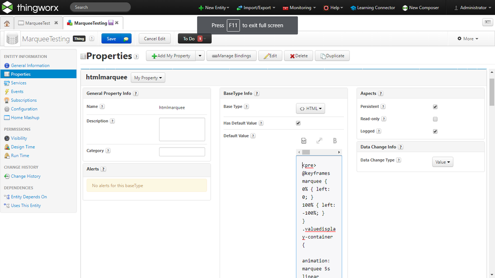

I followed your steps. I created a thing with property html and kept its default value as html script as u mentioned.
I had bound the getpropertyvalues service to the value display but it doesnt work in runtime.
Please tell me where I have missed.
Design
Property
Runtime
The value of the property should not include any css.
At the moment you will just see the property value which is your CSS definition.
The CSS needs to be defined in the "Custom CSS" section of the Mashup and the Property only holds the value to be displayed.

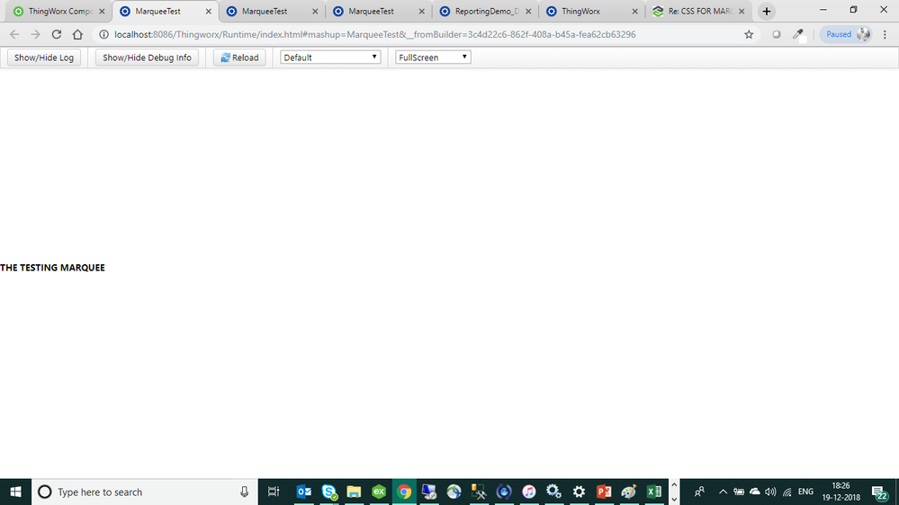

I followed your steps exactly. But the runtime text does not move. Is it because of version compatibility? I am trying this on 8.0
In the screenshot the CSS is in the "Custom Class"
It must be in the "Custom CSS" fields - for this you need the New Composer.
It's not accessible in the legacy Composer.
I followed these steps. The background color and text color is applied but the text doesnt move. The custom class of mashup is also empty. But it doesnt work.
Please help me on how to proceed.
