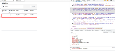

Remove or Change the selected cell's border in runtime,

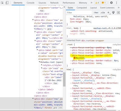

In runtime, i'm seeing CSS as follows,
How to apply in Custom CSS tab?  I don't find any configurations to change the border color.
I was able to override the color using this in the mashups custom css tab:
ptcs-focus-overlay {
	border-color: red !important;
To hide the border,
    visibility: hidden;
