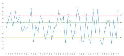

CSS for formatting the reference lines of a line chart
JK_10744682
@Jam_Kirko
Could you possibly share the CSS for changing a reference line color if you still have it--from this topic?
@supports (ptcs-style-unit: "PTCS-CHART-COORD") {
  [part~="y-refline"]:nth-child(1){
    background: repeating-linear-gradient(to right, red, red 4px, transparent 5px, transparent 8px);
    width: 100%;
    height: 2px;
  [part~="y-refline"]:nth-child(2){
    background: repeating-linear-gradient(to right, green, green 4px, transparent 5px, transparent 8px);
    width: 100%;
  [part~="y-refline"]:nth-child(3){
    background: repeating-linear-gradient(to right, blue, blue 4px, transparent 5px, transparent 8px);
    width: 100%;
  [part~="y-refline"]:nth-child(4){
    background: repeating-linear-gradient(to right, rgb(243 192 17), rgb(243 192 17) 4px, transparent 5px, transparent 8px);
    width: 100%;
Try to use the above CSS.

This is very helpful. Do you know of a way to get the colors to be by reference line number rather than coordinates? I want specific reference lines to be certain color but the CSS you showed has it so that the highest value line is one color and so on.
    width: 100%;
    height: 2px;
    width: 100%;
    width: 100%;
    width: 100%;
