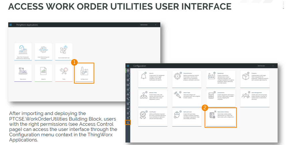

Quote: "After importing and deploying the PTCSE.WorkOrderUtilities Building Block, users with the right permissions (see Access Control page) can access the user interface through the Configuration menu context in the ThingWorx Applications".

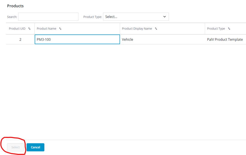

I tried the extension in 9.6.1 and found a bug. I am sharing it just to enhace further product development of this utility.
On the Single create work order page, once you pop the window to select the product. The product is non selectable.

Thanks for letting me know, i will look into this issue.
In the meantime, you can try using the drop-down product selection instead of the advanced popup selection. For a small number of products this selecting is easier to use anyway.
In Composer navigate to the "PTCGPX.WorkOrderUtilities.Manager" thing and select the Configuration tab. Find the "AdvancedProductSearch" configuration and uncheck the checkbox, save the manager thing after. (See user guide page 7 and 15)

Thanks @seb
That worked well.

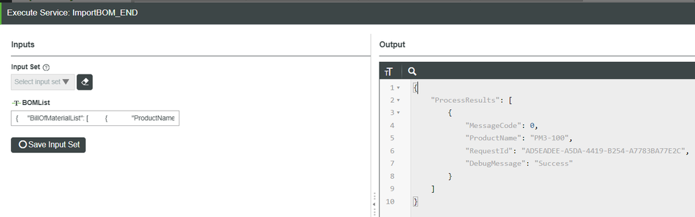

I am also facing another issue related BOM being not visible even after gettng a success message on OOTB ImportBOM_END service. As a result, I am not able to find the BOM in the Work order utility. Do you know of any reasons ? or maybe where in the UI, I can locate all the BOM's
"BillOfMaterialList": [
"ProductName": "PM3-100",
"Enabled": true,
"Description": "PM3-100_BOM",
"Items": [
"ProductName": "P-001",
"UnitOfMeasure": "EA",
"Quantity": 1,
"ScrapFactor": 0
"ProductName": "P-002",
"Quantity": 1,
"ScrapFactor": 0
"ProductName": "B-001",
"Quantity": 1,
"ScrapFactor": 0,
"Substitutions": [
"ProductName": "B-002",
"ProductTypeName": null,
"FactorOfConversion": 1,
. I am attachng the jSON as above and also the status message:

Can you please try executing the "GetBillOfMaterials" service on the PTC.SCA.SCO.DefaultProductManager thing, to double check if the BOM was created successfully.

I am getting no data.
I am still puzzled then why the importBOM service shows success message.

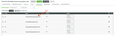

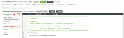

Check the PTC.FSU.CORE.Process.ProcessQueue_TM timer thing and make sure you have the TriggerUpdateQueueConfiguration_PRC, TriggerUpdateQueueNotification_PRC & TriggerUpdateQueueEventBased_PRC subscription enabled.
How the endpoint work is, when you execute an endpoint service for Work Order or BOM import, the service adds the request to a queue and the timer processes the queue every 60 seconds. The result of the endpoint service only indicates that the validation and adding the request to the queue was successful.

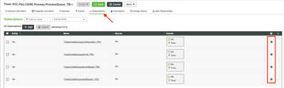

The subscriptions are disabled for me. I tried to enable them from the UI but no checkbox is there. Then I tried to enable them usng the service EnableSubscription by passing the subscription name in the argument. However, the service returns no results. Is there a specific way to enable these subscriptions.
This worked after a few refreshes. Now the subsciptions are enabled.

You can enable/disable the subscriptions in the UI as well. See screenshots below.
Now that the subscriptions are enabled check if the BOM was created, they should also appear now in the Work Order Utilities UI.
