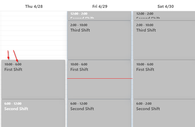

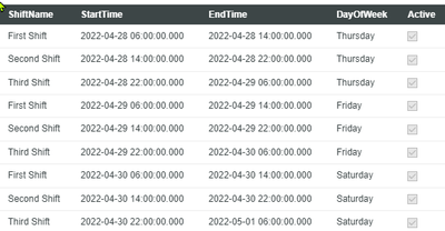

i am using the calendar widget https://github.com/ptc-iot-sharing/CalendarWidgetTWX and for some reason the times on the widget are +4 hours to my infotable date times. any advise?
This is my infotable
the widget

i had to change my computer time zone to "automatic", that fixed it
