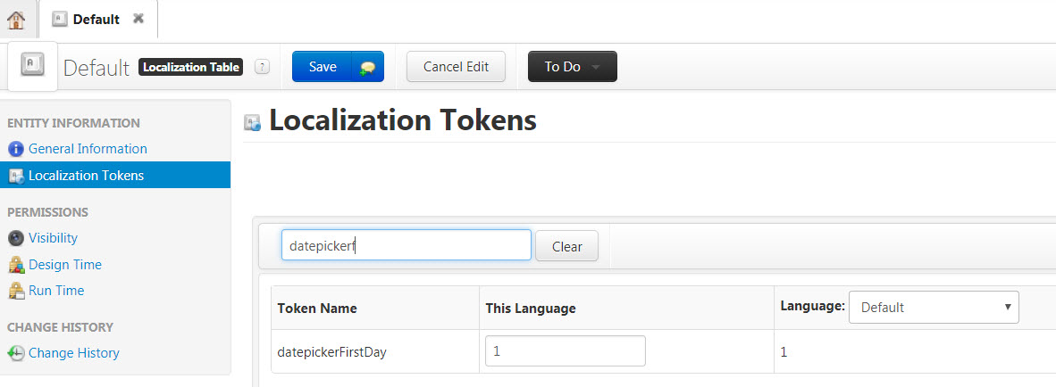

Calendar is showing Sunday to Monday when we click the calendar icon in a mashup. I want to change the day order and show Monday to Sunday when the user click calendar icon? Pl help!
1 ACCEPTED SOLUTION
jQuery is used to display the calendar and you can configure the calendar to show Monday as the start of the week by setting 1 to datepickerFirstDay in Localization Tokens. (0 to show Sunday as the start day of the week)
Go to Composer > SYSTEM > Localization Tables > Default > Localization Tokens set 1 to This Language row of datepickerFirstDay.

Hi @pselvaraj-1 which calendar widget are you referring to? Is it a custom widget or are you referring to the timeselector or datetime picker widget?
I am using datetime picker which comes with thingworx foundation.
It works, Thank You!
